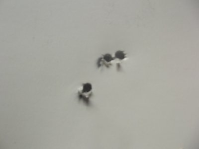

let's see if others see's what i see in this picture? they say a picture is worth a thousand words. this if from the 17-556 kak with 25 gr vmax at around 3750 fps.
Possibly.......a 10" twist barrel.....on a bad day??
Maybe......a fouled barrel?? Depending on barrel age/rounds fired.......it doesn't take much.
Any "vapor trails"....??
