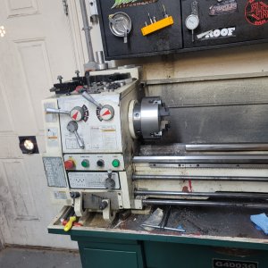

Tooling rental for a guy
want a pair of Defiance

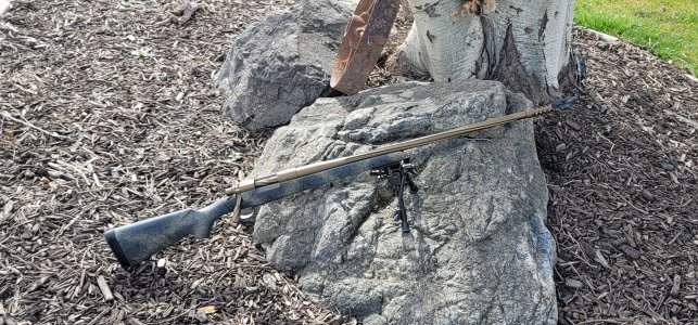

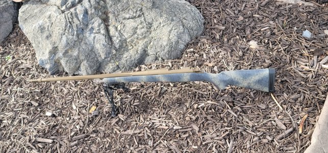

25 creeds 7.5 twist proof senderro contor 24 "
I got them done no big deal
few hours leftover weekend and I full A.D.D
Ye I now have a 25 creedmoore

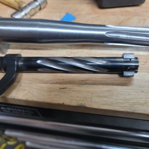

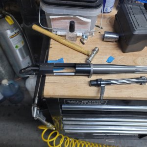

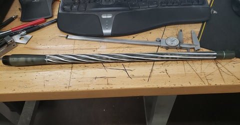

10 twist #4 Willson ss barrel finished at 24
Some homebuilt self timing brake 1/2 x 28

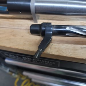

6 twisted fluting on the barrel
6 twisted fluting on the bolt
Mini sako extractor installed
Threaded for Tack knob
.250 Holland pined on recoil lug
700 with lapped lugs faced action and bolt face
Chased receiver threads pined lug
This one will not last long wen my wife finds out
I got Another gun. she keeps track of me in my personal bound book.

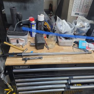

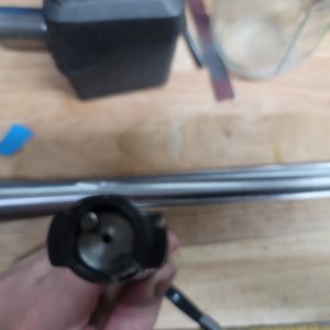

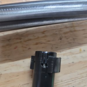

Bolt work
Great project. I have one in a 9 twist, using Alpha small primer brass. A 90 Blitzking at 3,425 fps just wrecks a coyote. Wish I would have gone 10 twist as I had a pile of 75 V-Max to use. Please keep us updated on your progress.

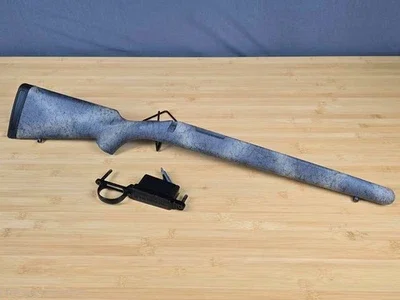

Just found me a stock
Bagram short action
On ebay its on the way

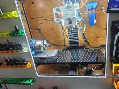

Some mill work

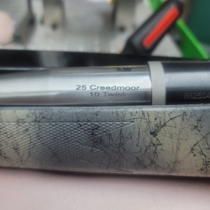

25 Creedmoor 10 twist

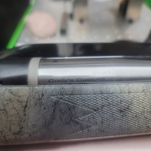

We will see how the cerakote goes might just fill in the engraving but you never know tell you try

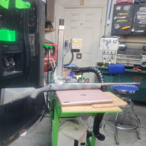

Bergerac Tupperware stock showed up not as bad as the rem Tupperware stock but it looks cool

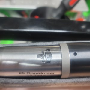

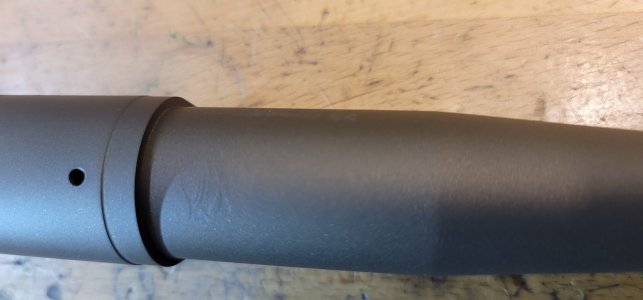

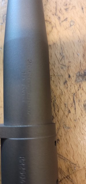

Well we now know
Need to do deep engraving carakot cover up the trump-stir and my name
Deep engraving came threw might run it 2x
To make sure

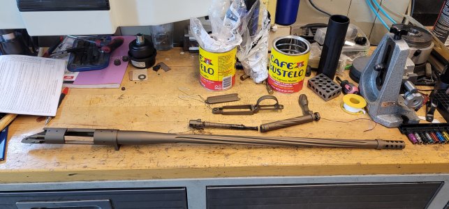

Cerakote done

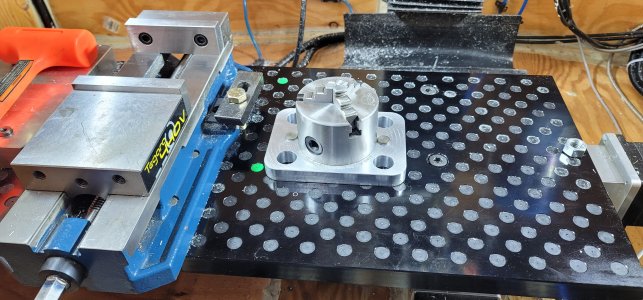

Also made a mill chuck for barrel nut project up comming
Wating for the bake time

New to me stock and bottom metal from a Bergerac doner
Need trigger pins a factory rem trigger out of parts bin

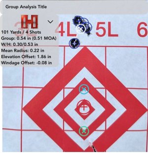

115 -85 gr should be fine in the 10 twist!

Be nice to see some exterior Balistics figures.
