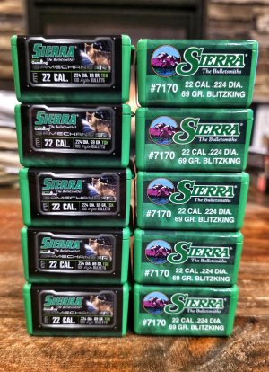

Btw, we pushed for the .224 69 grain Blitzkings for years, which were just released. The .224 69 grain TGKs will be released after the first of the year, though I did pick-up some of those. They were spendy, for sure!
