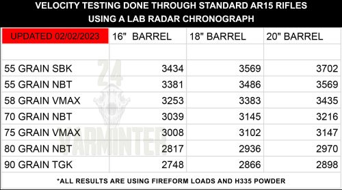

We are very pleased to announce the re-introduction of the new .24 Varminter. Please watch the video that discusses the technical side and ballistic testing with numerous projectile weights. These are NOT hot loads, nor are they showing any signs of pressure on the brass, or primer. Here is the original video, along with the velocity tables that were recently updated.
This video includes Cache Carlson and myself discussing the more technical side of the .24 Varminter cartridge, including some history, the parent cartridge and velocities using numerous varmint style projectiles:
