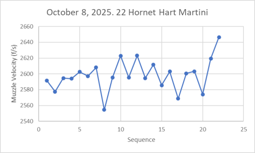

What are the readings from your Garmin?

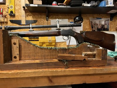

Btw that’s a nice looking Martini.
Here's a Martini Cadet in 17AB.......left to me by my old hunting/fishing/gun show/gun range pal. Built at Knight's Gun Store, Ft. Worth.......circa 1968.

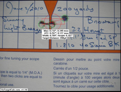

Using the 40 V-Max, I had the seating die set to produce SAMMI length. Hmmm. I measured how much I was jumping the bullet - 0.100 or so! I think I know what to try next. On my K-Hornet Cooper, I seated that bullet to touch or jam and that worked.
Hornets are very hard to get consistent velocity from. I have found 12.6 grains of Lil'Gun, Fed Small Pistol Primer and 40 grain Vmax or Blitzking, no crimp, will shoot well under an inch in over 30 22 Hornets we have tried the load in. The small pistol primer is recommended in the Sierra load manual and produce much more even ignition and tighter SDs, some replicate this with a light crimp on the bullet. We have never found a Hornet that would not shoot this load, If that load does not give tight SDs and groups in the .75 or better range, then there is something wrong with the rifle itself.
It has been producing these kinds of groups for 30 years. The target squares are 1/2" on a side, rather than the standard 1".

Nice 3-shot group -
I agree. Rifle or technique (sic.) problem, most likely.
