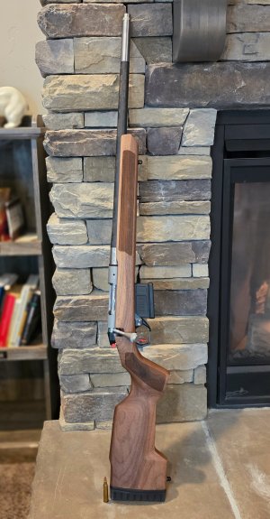

New .220 Swift Ackley Improved Bolt-Action Build
.220 Swift Ackley Improved (40 degree):
Spartan Precision Rifles - Gunsmith for chambering, mounting and threading.
Bergara Rifles - Premier Action
MDT Tactical - TIMBR Core Stock & AICS Bottom Metal
Elftmann Tactical - 700 SE Trigger (discontinued)
Proof Research - 23" Barrel - 1:8" Twist - Approximately 7-8 years old.
Built as a lightweight, longer range, coyote/badger/rockchuck rifle. I will be shooting the Sierra Bullets 69 grain Tipped Game King and 69 grain Blitzking bullets.

Where's the optic of choice?
According to MDT, it is made from one piece of walnut. I really like that it's not glossy, but more satin. It is not very heavy, either.
That's what I really like is the satin finish.

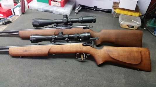

Majority of the time if I redo a wood stock I just use Watco Danish oil finish on it. It adds color and seals but no shine.
