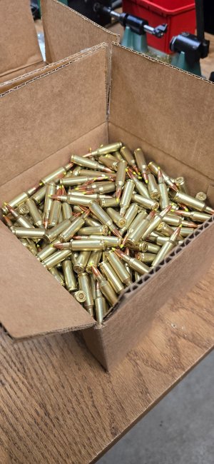

Started getting ready for our annual SD PD trip. Oh how i hate prepping brass.
FL sized, trim to length and inside outside chamfer case mouths.
1k 224 Valkyrie, 500 224/24 Nosler and 600 24 Nosler. Just got some chamfering to do then I'll be ready to start loading.
Once those are done I'm gonna work on my 20 Tactical.
So sizing with Rock chucker supreme, with Lee and Redding dies.
Trimming is done with WFT's in my drill press.
Chamfering is done with a Lyman case prep station.
Finall assembly will be with my Dillon 550B without the sizing die in it. Just prime, fill ,seat, crimp, done.
Now if I'm not crimping the rounds, I'll just check the cases to see if their within spec for case length .
Chamfer the cases and do everything on the 550B.
