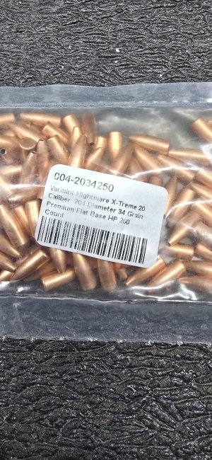

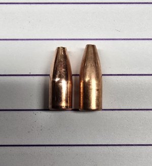

So why don't you split the difference and shoot the Varmint nightmare x-treme 34 grain. .16 a piece and they shoot just as good as their 17 cal nightmares. My 20 tac is shooting them just as good or better than the 32 grain Nosler varmageddons.
