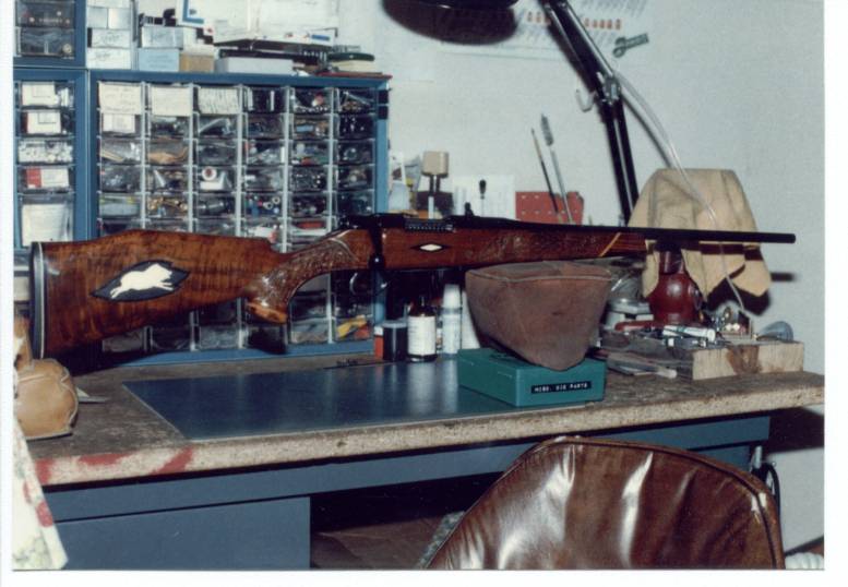

Here's a semi-custom H&R/Shilen in 17MachIV......that I bought from Todd Kindler, over 35 years ago. .

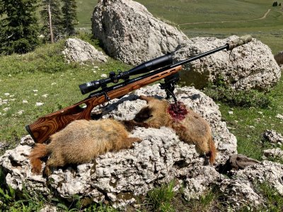

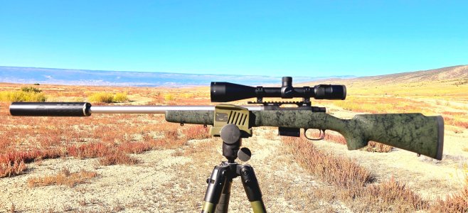

Admittedly, I only own two 17 caliber rifles (Anschutz 17HMR and Savage 17Hornet), and they both perform admirably when pressed into service on all manner of varmints at the appropriate range. But the OP asked about the most efficient centerfire cartridge, so my vote goes to the 17Hornet. I replaced the stock barrel with one from Lilja and when I do my part, it easily reaches out to 350 yards.
The following picture was taken in the Big Horn Mtns of WY and as you can see, it got the job done.

Very impressive Paul, l bet that Lilja is a 9 twist and you used a 25 or 20 Vmax. Do tell us about your loading please.

Back in the day we had lots of 17 caliber bullets to choose from,today not so much. I feel obliged to mention how well the 20vmax shoots in my 17 Ackley Bee and think I need to lay into quite a few thousand more while they are still easy to get. I always wished Hornady would make a 30 vmax for bigger 17s,but judging by your picture it may not be needed.

Matt - Yes, the Lilja barrel is a 9 twist and the two rock chucks pictured fell victim to a 20 grain V-Max. However, I've not yet taken the leap and delved into reloading this caliber nor any of my other centerfire rounds. Therefore, I'm relegated to using factory loads and having to be satisfied with the results. Yes, I understand and accept this does leave me well short of realizing the full potential of this and other rounds. Perhaps I will finally see the light and take that step at some point, but as I've mentioned to others who have also provided encouragement, for me it's not so much an issue of the cost but being able to strike a balance between taking on another hobby and the time and effort to master the process.
Wow Paul with results like that I can not fault your decision one bit. As a young man wanting to shoot my Grandfather's WW2 1911 and thinking factory ammo was too expensive I got a Rockchucker press and some Sierra 185s and proceeded down a very deep rabbit hole. For myself I find the time at the reloading bench is a very relaxing endeavor and a big part of the fun found in shooting. Sometimes it can become a bit tedious and I find myself gravitating towards the rimfires for a break. I am sure when and if you choose to tackle the reloading aspect you will find it fun and very rewarding.
