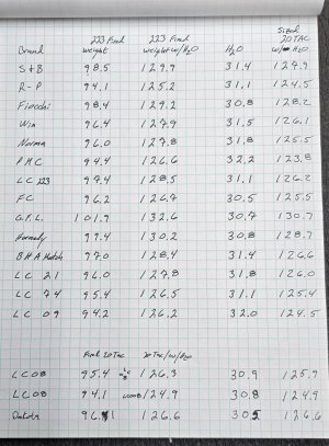

So I've got aboot 200 20 tac from Dakota brass.
I wanna make more. Ive got the Redding forming die and plenty of brass. But what brass should I use to get close to Dakota 20 tac brass.
Ive got LC and lots of regular 223 win from different manufacturers.
Anyone know whats close?

I would find whatever has as close to H20 capacity as the Dakota starting with your LC brass.

I would try and find 223 Lapua and I'd bet the volume is similar. Just gotta live with the different headstamp. I wouldn't mind that problem 😉
Thanks guys
Ill give those a go and see which is closer.
Ive got prolly a few Lapua 223 brass mixed in with the 1k 223 cases I have but not gonna dig fur them .lol
The only info I can find says Lapua, Quality cartridge and later Hornady made the brass for Dakota Arms.
