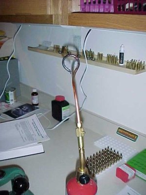

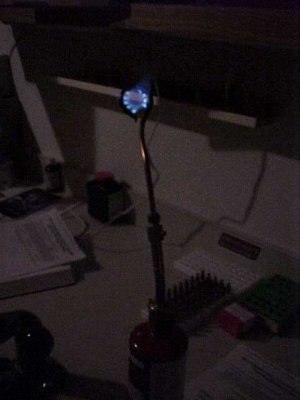

I have found that it is important to anneal these cases to achieve top accuracy and ensure adequate case life. It is less important on some cases like the Mach IV, but I still choose to anneal. I have purchased a Series 2 Annealing tip from the Woodchuck Den that I use to anneal the cases once I have formed them. The phone number for the Woodchuck Den is in my Links section of the page. I have included a picture of this tool below. I place the cases in a baking pan with " of water. I anneal each case individually and nock over with the annealing tip into the water to quench. With the annealing tip came instructions to anneal each case for approximately 15 seconds. I have had a little better luck with close to 20 seconds, but the key is to not over heat the brass. I have found that the annealing tip makes this task rather easy, and now I dont regret annealing like I used to. When annealing the cases, you want to hold the flames at the area that is to be stretched during the fireforming and then upwards to the neck. You do not want to heat the brass until it gets red, you just want to heat until the case begins to discolor to a blue/green color a little. Overheating can ruin the brass.

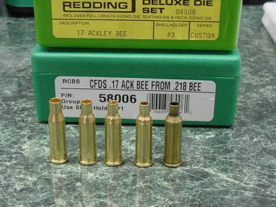

Shown above is a picture of the transformation of .218 Bee case to a formed .17 Ackley Bee case that has been fireformed.

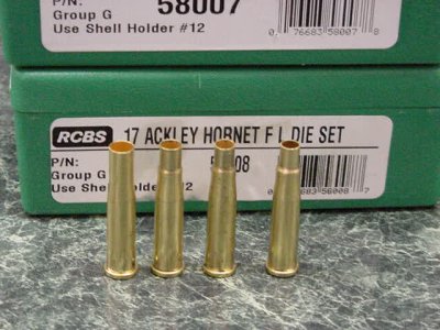

Here are the .17 Ackley hornet case forming steps. Here the transformation is showing the results from each forming step. The fireformed case is not shown, but will be a straight wall case with sharp shoulder angle.

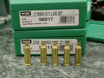

The Mach IV case doesn’t have to transform nearly as much as the previous cases mentioned. The forming steps make the case look like the real thing even before fireforming in the chamber. The shoulder angle is not changed and the location of the shoulder is preserved so that the case looks great from the start. same number of steps are required to form these cases.

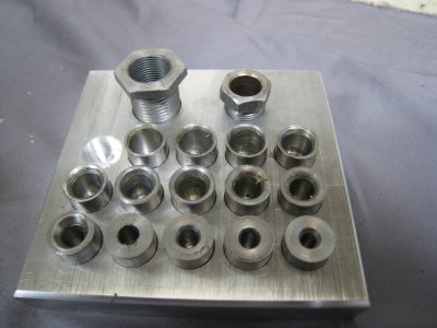

When I joined Saubier many years ago there were a number of references to various forming dies and processes step by step to form various cases, perhaps some will join in and post pics of their forming die and perhaps a few posts on the steps needed to form various small caliber cases ie 20 Vartarg from 223
Is anyone using hydro form to form cases?
