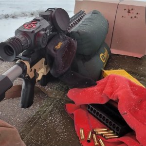

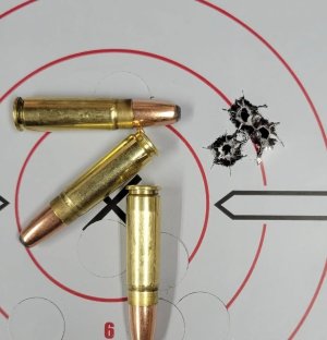

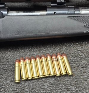

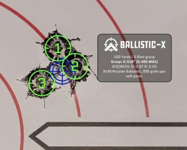

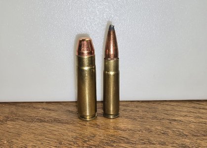

I made a wildcat i call the 401K.
It's a 7.62x39 blown out and necked up to .40 cal.
Was wanting it in a AR platform but having issues with it feeding from a mag. Right now I've got it in a Savage 12 bolt action.
Shoots pretty good but haven't got to really working up a good load.
It needs longer bullets to assist in feeding from mags.
I also just got my dies aboot 3 months ago after a 2 year wait.
