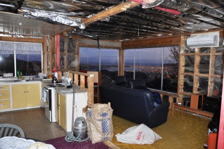

The house came first, we took out a load bearing wall, opened up the area between the kitchen, dining area and lounge, fitted a laminated beam into the ceiling to take the load of the load bearing wall. Removed all the wall linings and installed insulation, removed the ceiling and installed a new ceiling, added led lights additional power sockets etc.
Downstairs there were 3 big concrete piles removed, some PFC bolted to both sided of an existing floor bearer that the floor joists rest on, part of a support was had pfc bolted to both sides of the top plate and the studs and footing were removed.

Interior lining removed and getting ready to remove the wall on the left in the 1st photo, notice the wall removed had windows in it.

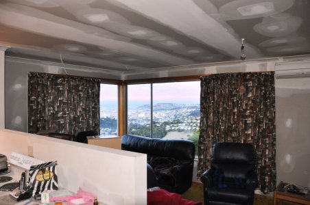

Laminated beam has been installed and top portion of the wall removed, we lined down the stairs to the basement
We have a new ceiling (it looks better after painting. The two pfc have been bolted to the top plate and the studs and footing are next to be removed

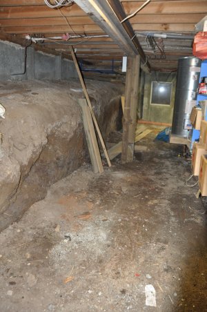

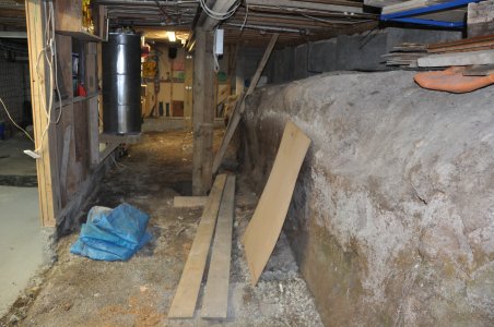

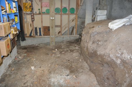

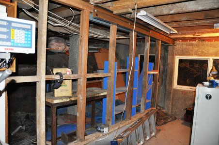

So here are some pics of what we started with
You can see the 2 pfc's that were bolted to the top plate of the floor joist support wall and through the wall framing you can see another concrete pile that was removed. Approx 4 studs were attached to the stud just this end of the pfc's and they support this end of the pfc's.
The remaining studs, the bottom plate and the concrete nib wall was removed to make a larger opening to access the other side.

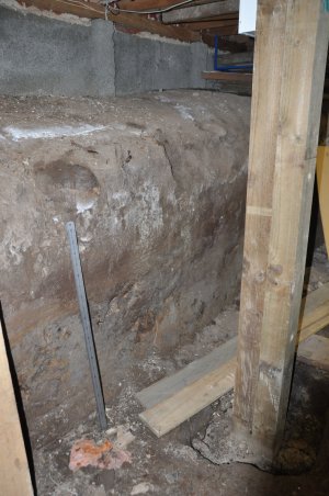

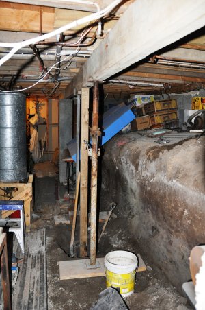

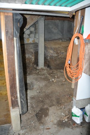

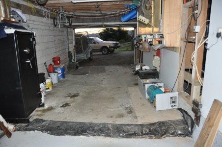

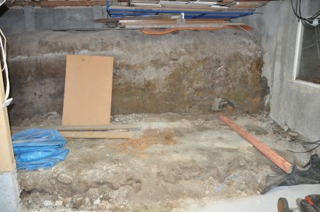

You can see the asphalt floor in the photo looking toward the door, no it isn't level it sloped down from the right to the left and toward the doorway. The grey bit of floor is the concrete floor I had poured shortly after moving in and yes the asphalt floor was considerably higher than the concrete. In the other photo taken after the studs, and nib wall had been removed it shows the other side of the basement, the floor was dirt and about 14+ inches higher than the existing concrete floor, and a big bank partway across that went all the way to the existing foundation wall.
This is the opening at the other end of the support wall, it shows the dirt floor and the bank at that end.
The above is a view showing the length of the side that needs dug out from each end

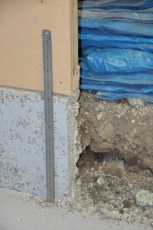

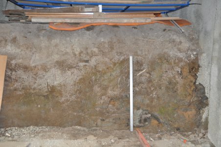

This gives you a scale of size. the nib wall is just over 400mm above the concrete floor and the ruler against the bank is a 1m ruler.
We had to empty out the basement area to enable access to get the dirt & rock dug out. It took quite a bit to get find someone to dig the basement out. Most looked at our driveway and either said they didn't want the job or the price was that high I could almost build a house.
