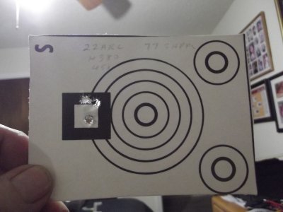

i have been goofing around with a wood stocked 1500 mini in 22 arc. the rifle has a 1-7 twist. i tried 55 gr hornady spire points. they did ok with 3/4" groups. had simular results with 60 gr sierra hp and 69 gr hp. then i tried 75 gr amax, 1.5" groups at best. then i decided to try 88 gr hornady and 77 gr sierra hp. the 88 were just like the 75 amaxes. then i tried h380 with 77 gr sierra's and i have posted the target pics. load were around 2900-2926 fps.
