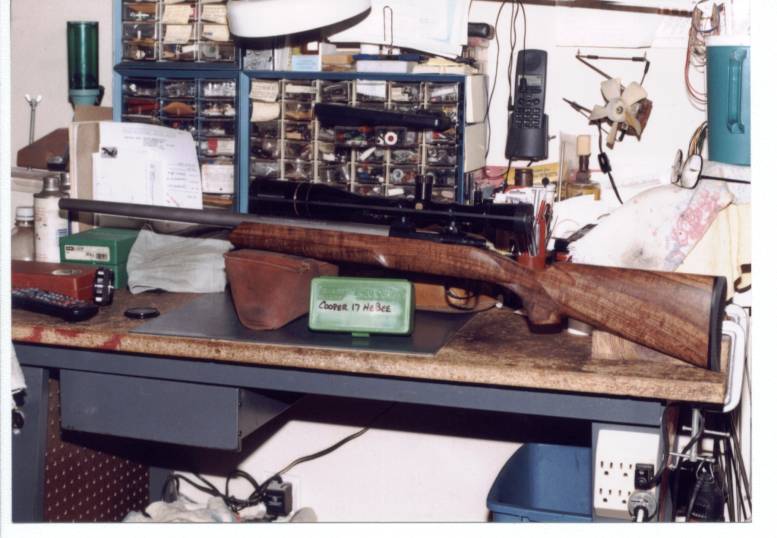

Figure 4 shows the Encore with Bullberry stock set, and 20" full bull bullberry barrel in .17 Hebee (try saying that 10 times). The fit and finish of the stock set are excellent, and the quality of the wood is breathtaking. A picture just cant do this wood justice. The 2" wide target style forearm matches the stock beautifully. The Swift 6-18X 44 scope is mounted in Burris Zee rings on a Weaver style base.

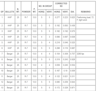

For fireforming, I used a reduced powder charge (13grains) of Reloder 7, and a 25-grain Hornady hollow point. I didnt intend to use 25-grain bullets in this cartridge, but the heavier bullet helps to ensure that the case is formed fully during fireforming. There are other methods of fireforming, but this one was successful for me, and the fireforming loads actually performed very well, and I used them also to break-in the new barrel.
I first loaded one round with the reduced load and fired it to see if it would blow out the shoulder completely. I seated the bullet to just touch the lands. It worked, so I loaded 50 prepped cases. I only had 50 Hornady 25-grain HPs left, so I stopped loading when I ran out.
I used the first 13 rounds to break in the barrel and sight in the scope, cleaning after each shot. Then I began the sequence of 1 fouler out of the clean barrel, then 5 shots for the group, then clean after each group.
I shot 6 groups at 100 yards using the Hornadys with an average group size of .581". The largest group was .687", and the smallest was .436". I loaded the rest of the fireforming loads with 25-grain Bergers, just because those were what I had on hand. I shot some groups using these and had a best of .311" and a worst of .856" at 100 yards. Seen in Figure 5 is a group shot while fireforming. I shot a few over a chronograph to determine the velocity of these loads as well, and got an average of 3,290 fps.

Table 1. Fireforming Loads

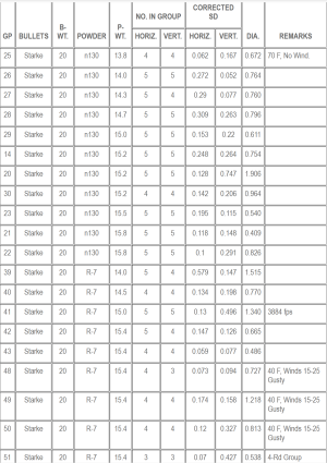

I then switched to Reloder 7 and loaded up to a maximum of 15.4 with the 20-grain Starkes. I had some primer cratering with the Starkes at this level but no ruptured primers or sticky extraction. The Starke 20-grain bullets proved to be great with either of the two powders, with some of the groups being in the .3 - .4 inch range. I was unable to get a chrono reading on the Starkes with the n130, but got a velocity of 3884 fps with 15.4 grains of the Reloder 7. See Table 2.
Table 2. Starke 20-Grain Bullet Loads

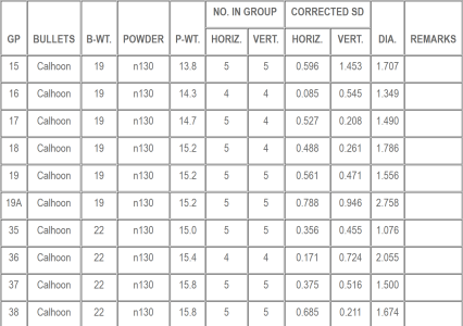

I then loaded some 19grain Calhoons using the n130 in the same manner. The groups with this powder/bullet combination were not as promising as I had hoped, so I discontinued further development. One thing that I noticed was that the suggested maximum velocity for these is 3800 fps, and I am sure that I exceeded this velocity. I loaded some of the 22-grain Calhoons with the n130 also. Although better than the 19-grain Calhoons, this combination didnt suit my Hebee either. I would still like to try some heavier Calhoons at a velocity around 3700 fps to see if I can find a combination that extracts their potential. See Table 3.
Table 3. Calhoon 19-22-grain Bullet Loads

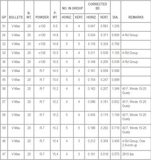

Still using the n130, I loaded up some of the Hornady 20-grain V-maxes. I got up to a maximum of 15.5 grains before I started to see some primer cratering. At this charge, I recorded an average velocity of 3844fps, a little lower than I got with Reloder 7. I probably could have loaded these a little hotter, and I intend to try some at 15.8 grains.
With 15.4 grains of Reloder 7, the V-maxes achieved an average velocity of 3915 fps out of the 20" barrel. With the Encore, I could feel some sticky extraction when opening the breech with these loads. The primers looked cratered and flat, but didnt leak or rupture. I reduced to 15.2 grains and didnt experience any additional problems. I will have to keep an eye on this load and possibly reduce further for warm weather shooting as it was 40° F when I shot the load at 15.2 grains, compared to 70° F when I experienced the pressure signs with 15.4 grains.
Accuracy with this load was good, and I plan on doing some follow-up work to evaluate further. I did have some impressive groups with the v-maxes and Reloder 7. See Table 4. All measurements are in inches; range was 100 yards.
Table 4. Hornady V-Max Bullet Loads

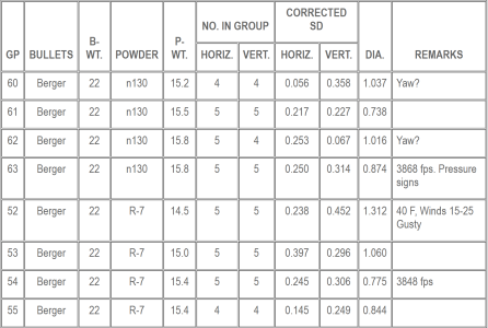

Shortly before press time, I received some of the 22-grain Bergers that I had ordered some time ago. As most of you probably know, the Bergers have been difficult to get recently. I will need to spend some additional time with these, as the gusty wind would not cooperate on the day that I was testing. In spite of the wind, I did have some pretty decent groups with the Bergers with both powders. The velocity of the 22-grain Berger with 15.8 grains of n130 was 3868 fps, but showing some difficult extraction and primer cratering. With 15.4 grains of Reloder 7, the velocity was 3848 fps. Even with a wind of 15 25 mph, I had a couple of groups measuring less than .75". See Table 5. Studying the targets several days after firing these loads, I noticed two or three oblong bullet holes, suggesting that some bullet yaw was induced, possibly due to too hot a load.
While there is always additional load development that can be done, I feel that I have some very good loads. The gun looks terrific and performs well, but a lighter trigger pull would be welcome.
Table 5.
Berger 22-Grain Bullet Loads

A pic of my 17HeBee.......set up for pds.
