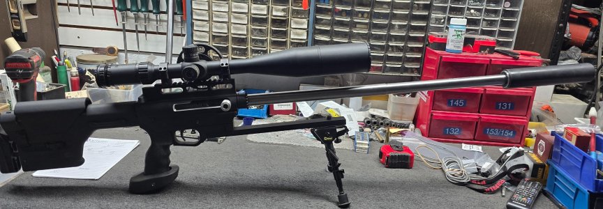

Ive got a AR-17 i built but it's a single shot. I had a bunch of parts and time to waste.
So i used a 55% lower which i called it because unlike the 80% lowers. It didn't have the mag well cut out or the trigger group done either.
Also made my own bolt handle for side charging. I wish I would have made it LH side charging.
Call it Frank for short.
