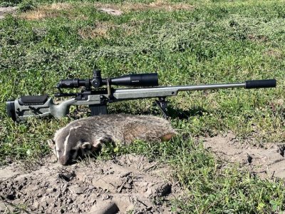

Anyone else into it getting into long range varmint/predator hunting? This past fall I built a 6mm284 in collaboration with Varminter magazine. We went with a 26” 8 twist heavy profile Criterion barrel, Warwick Tactical 715 short action, Grayboe Core stock, Triggertech diamond 700 trigger and topped it with a Arken EP5 7-35x56. I’ve been focusing on 105 Berger VLD Hunters at 3325fps at the muzzle. So far my longest shot is 772 yards on a badger, my son, 13yo, had his longest shot at 533 yards also on a badger. As of right now, I only have 80 rounds through it and am starting load development with 80gr NBT’s.

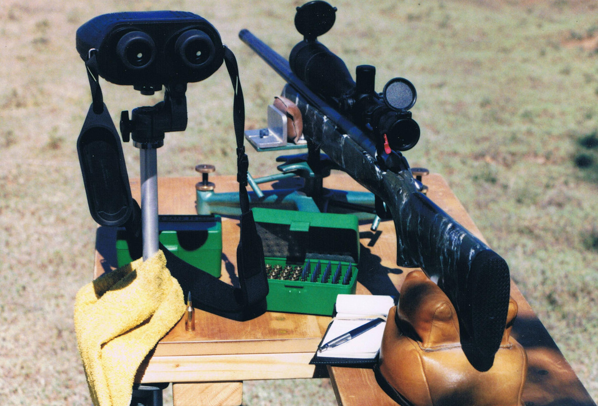

Here's a pic of my Searcy 20BR, with Leupold 8.5-25AOSF-VH. It shoots the Berger 50LTB at 3950fps.....and a 40VMax at 4150fps.
My best shot was a pd at 792 yards.
Then there's my 40XBR 22-250AI, with Leupold 24XAO Target.
Good old times......on the Texas High Plains.

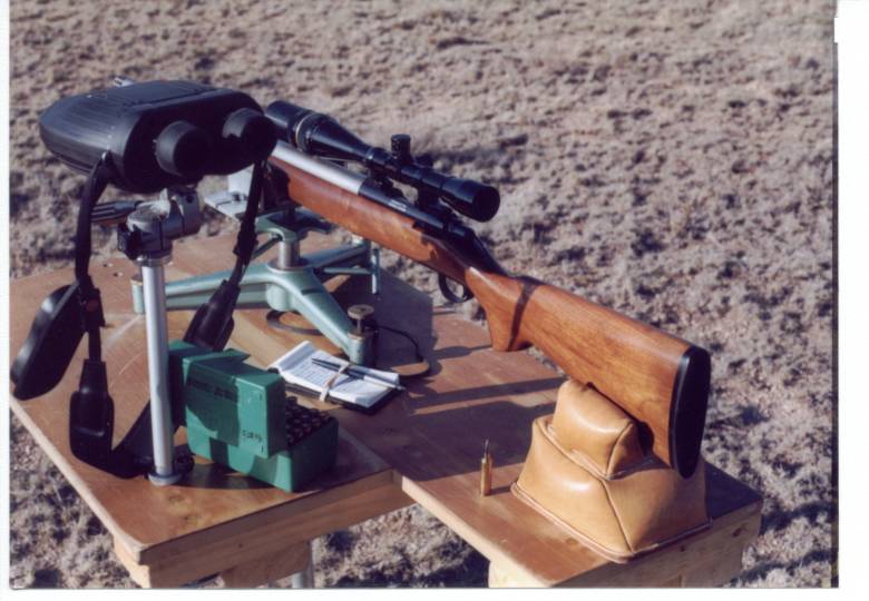

In 2000 in Montana, I made my longest shot on a pd at a lasered 841 yards with my Holland-built 243 Ackley shooting 70gr NBT's.
Built on a M700 action, blueprinted, Holland V-Block design, Jewel trigger, Holland QD brake, Holland lug, 24" Pac-Nor Super Match SS barrel in a McMillian Marksman stock, skim bedded. Leupold VX3 6.5-20X.
