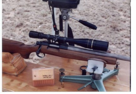

This 17Javelina had 4000 rounds(documented)through the Shilen barrel before it was re-barrelled. The cleaned barrel would only shoot about 10 rounds......before bullets would start to tumble.......at about 4000fps.
Upon re-barreling my gunsmith sectioned the old barrel length-wise.......to find that 7" of rifling, in front of the chamber, was GONE!
I re-barrelled with a 27" Pac-Nor, 3 groove, 9.0" twist.......added new stock, new scope, new trigger(no pics yet).
