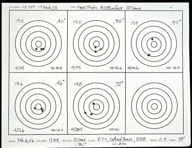

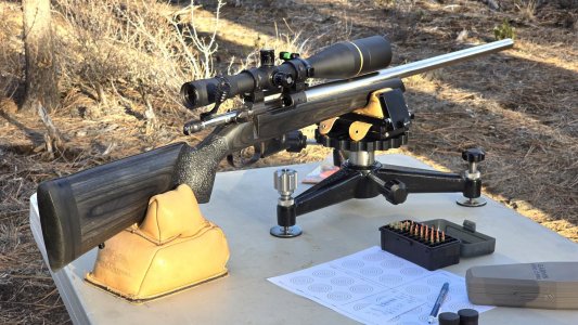

Added another 17 caliber to my collection, a CZ 527 17 Mach IV, and took it out for it's first firing today. I'm glad to say, it shows potential with 8208 and 20 Vmax. I picked it up from the FFL Wednesday, and I've been jonesing to go test it out! It's made by Gre-Tan with a 24" Douglas match barrel, and it's got some weight to it.
First test shots, to see if 8208 has potential with 20 Vmax, form some brass, see if it functions as it should.
