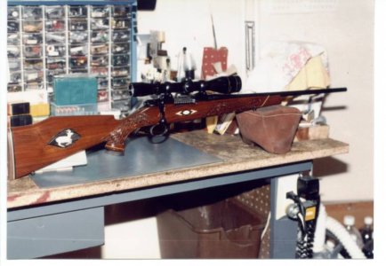

The Sako L461 action works fine with the fireball case.
Here's an O'Brien L461 in 17MachIV.
